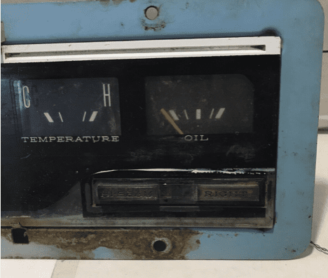

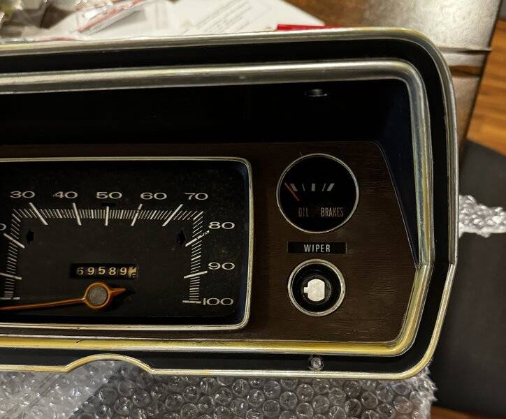

Been thinking through these details the last few days and I think it would work but wanted to pose the idea here to get thoughts. I know I could add a mechanical gauge but I'd rather have one tucked within the instrument cluster that isn't carrying oil. So this discussion will be if the concept is feasible/would work

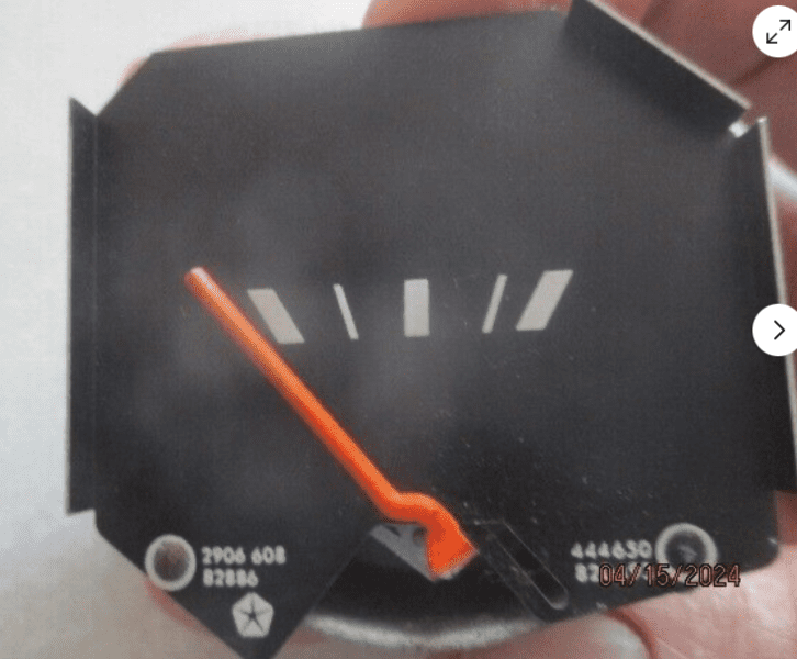

The gauge from a late 60 early 70 dodge truck. I'd have an overlay printed to add some numbers to the face to copy the look of the temp gauge.

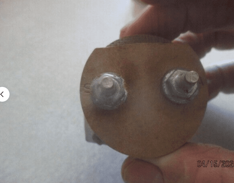

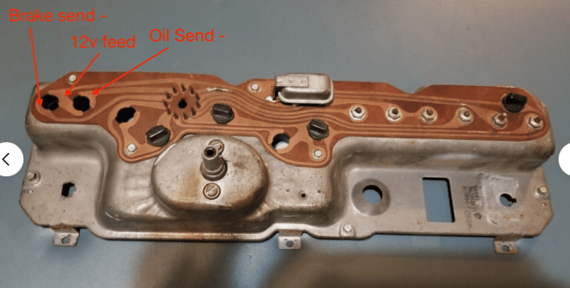

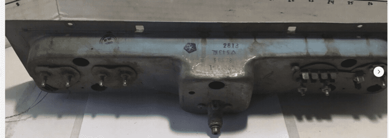

Doesn't appear to be using any kind of PCB for this cluster and I'm not seeing any voltage regulator. Assuming the oil gauge would be 12v driven or (regulated within the gauge)

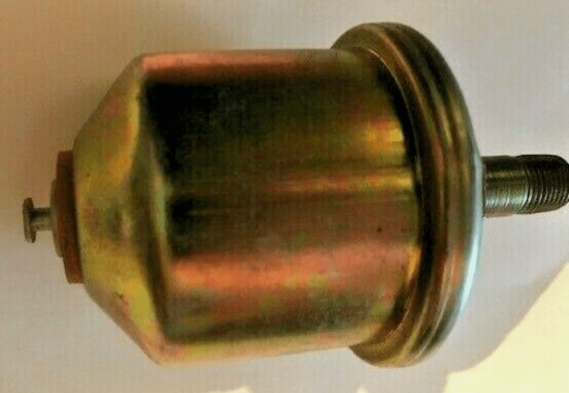

Here is the Oil Sending Unit to drive that gauge. Just swap old for new

71+ board
I would use a nylon hat washer that's sized to the diameter of those bulb holder holes and run the gauge posts through them and hold them in with some speed nuts like the ones on the fuel/temp/ammeter gauge posts.
Jumper from oil send trace to appropriate post on gauge. Jumper ground to the other post.

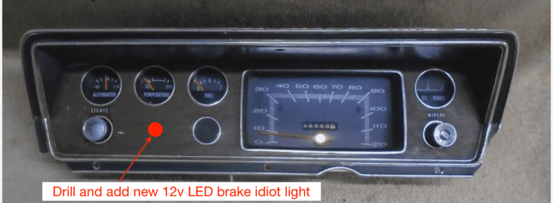

I will have to look at the cluster bezel but I think the OIL BRAKES text below the idiot lights is on a piece that can be removed from the cluster and modified with an overlay that simply says OIL

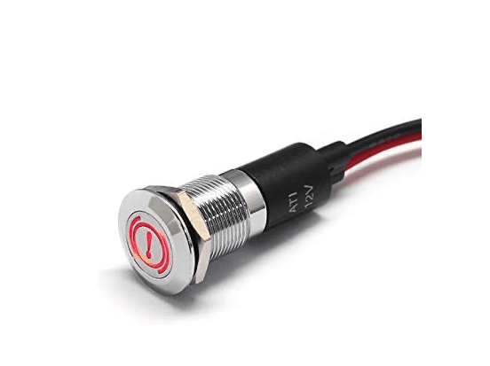

install one of these for the new brake idiot light wired to ground and original trace feed.

Great idea. I would want to validate what those marks on the gauge mean. Assuming they are for 0 20 40 60 80 but something like this you'd want to be sure of. You could also use a meter match to correct any inaccuracy of the gauge.
The gauge doesn't connect to sender and ground- the sender is a variable ground. The gauge gets a 12v feed and grounds through the sender (which varies depending on oil pressure, which gives you your gauge reading). So, 12v from the panel cluster (fuel and temp are regulated by the IVR to ~5v, so don't use those) and the sender wire would be your 2 connections.
The factory oil pressure sender and gage used the IVR.
The replacement senders do not seem to have the same calibration as factory 60s and early 70s senders.

Correct me if I’m wrong but couldn’t you use rubber washers and attach ring terminals to the posts on the gauges?
Maybe but the holes behind those dummy lights ( through the back side case) are also much bigger than the ones for the gauge. You’d probably need to weld those up a little so the gauge posts and rubber washers have something to snug up against
