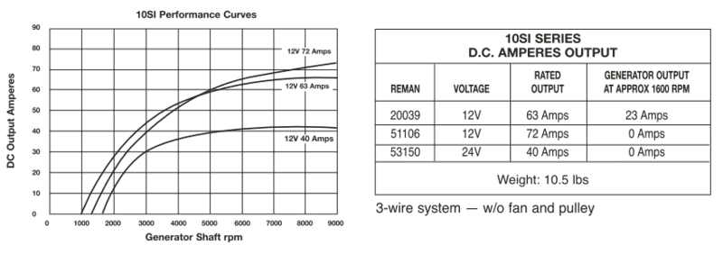

Here's an example from the 2008 Delco Remy selection guide. (GM 10 SI alternators).
Depending on the pulley ratios and the loads at idle, the alternator rated "63 amps" could be a better choice than the "72 amp" version.
