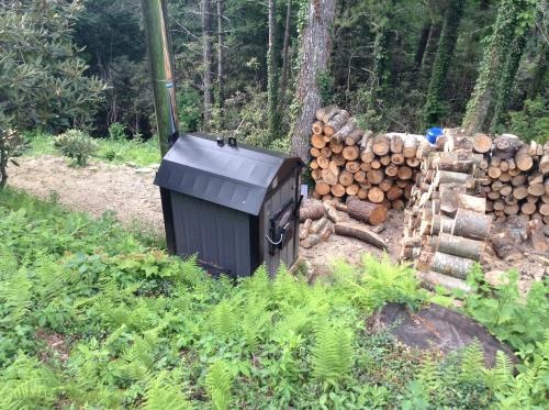

We heat with a 245,000 BTU Propane boiler. And we also burn wood in a wood insert
"Wood is Primary Heat" last winter was so cold that we went through 4.5 cords of wood and
2000.00 in Propane at 4.00 a gallon:wack:
So we broke down and bough a Central Boiler Outdoor Wood. With being a HVAC/Plumber service tech I installed everything my self here is a pic of what I did after work.
It's supposed to be down in the 30's this weekend so good time to try it out.
This is a 350,000 BTU plate Heat Exchanger that will heat the water on the inside boiler to
170deg with out burning gas

What did you use to insulate the lines running from the fireplace to the house? Do you know what type of temperature loss you have from the fireplace to the house?

Yes I used all PEX it s a special PEX made for Hot Water Systems. I could have ordered the pipe from the company I got the stove from for 1200.00 but I'm a Tight *** and made mine with 1"x3" wall insulation in coragated drain line and piled it through with my pickup and sealed the ends with foam.
:cheers: pain in the butt but I have 6000.00 in everything including stove trackhoe rental etc
