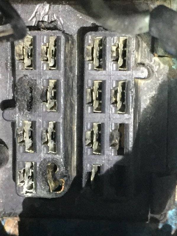

ALT gauge issues- clicks and pulses 69 DART. NEED HELP!!!
Ill chk n see if they have 10 ga.
Is it a special crimper? Post pics if n when you can.
Thanks
Steve
Thank you Steve-
This is the crimper: Delphi Packard Five-cavity Wide-range Crimping Tool 22-12 AWG / 24-14 AWG
That's the one Doug, you will be a wiring Guru when this is done.
I WORKS ON Packard PROB A FEW OTHERS STEVE IT DOES THAT NICE FOLD OVER CRIMP LIKE THE FACTORY. Opps cap lock.
Thanks so much... but I ordered a variety of gauges from an Ebay seller along with terminal release tool and crimper (thanks for the guidance/help Ray).
The only ones Im having trouble finding are the 10ga...
The 10-12 are for 10 and 12 ga so you are good.
No they just crush a connector that's the way the crimp on general terminals work, the Packard ones have to get a fold and then a crimp if you follow what I mean.
