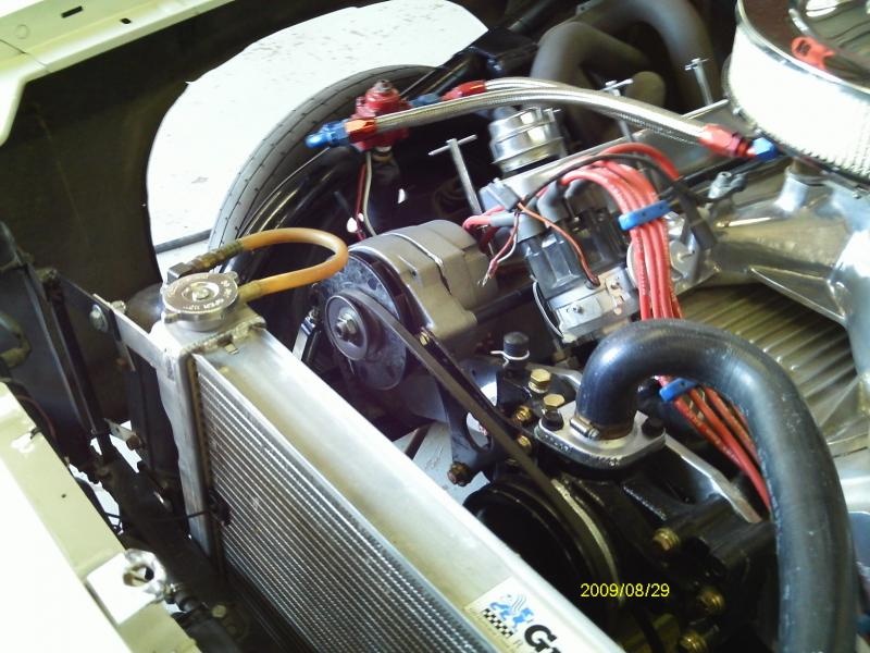

http://www.forabodiesonly.com/mopar/attachment.php?attachmentid=185395&stc=1&d=1287983866
Fixed my problem. my car has the newer style voltage regulator (flat chrome box) and i noticed the alternator that was on the car had a internal regulator. went to the auto parts store and bought a 60a alternator. bolted it on and now instead of low voltage i was pumping out 17-18 as soon as i got past 1800rpm's. spent all day studying wiring diagrams, everything was checking out, all the right wires to the voltage reg, battery, resistor, etc. bought a new voltage regulator, that didnt change anything. then after multiple tests with lots of voltmeters etc on the alternator, battery i noticed that my volt gauge was pulling its positive source from one of the two wires right off the voltage regulator. seemed like that probably wasnt a good idea and sure enough. snipped the extra red wire, and now the battery isnt over charging, the alternator is regulating and putting out the right amount now! also the previous owner who swapped the car over to electronic ignition replaced about 4 wires in the loom all to the color blue....nightmare for trouble shooting! and just to keep things on track with mopars, as soon as i got this problem figured out i noticed that my master cylinder is now leaking under my carpet(old carpet) so off to fixing another problem!
just kidding about fixing it.....with the new 60a alt, new ballast resister, new voltage regulator, and the volt gauge wired correctly still over charging. while driving if i stay around 2krpm it will read fine at about 14ish. as soon as im at freeway speed close to 18 with out accessories being used. ive been turning every accessory on while driving to keep it from over charging cause its my daily driver but i really need to get this fixed.
could i possible have got the wrong alternator that my voltage regulator cannot regulate. ive printed out about 3 different electrical diagrams and compared the wiring, everything looks to be wired correctly. the alternator came with one field tab, a vacant field tab, a ground tab and the battery post. because my previous alternator had two fields i removed one of those tabs and put it on the new alternator. i currently have both fields hooked up and the battery post, not using the ground.
It's difficult to picture what you've done here, it's POSSIBLE that the regulator is not even in the circuit, that is, you have created a situation where the alternator is being "full fielded" and charging full output regardless
