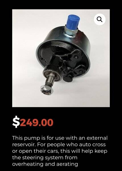

For all that have done the RMS conversion, what steering pump setup did you use to power the rack?
Links, photos are encouraged.
from my experience, all Mustang II / Thunderbird power steering racks can use the same pump as the 60's and 70's OEM steering box. Some like to upgrade (?) to a more modern compact pump.
Aluminum Power Steering Pumps w/ Reservoir
HDK makes aluminum brackets for the compact pump for most small block / big block / Hemi applications.
Yeah, I think that's the direction Ill be going.
