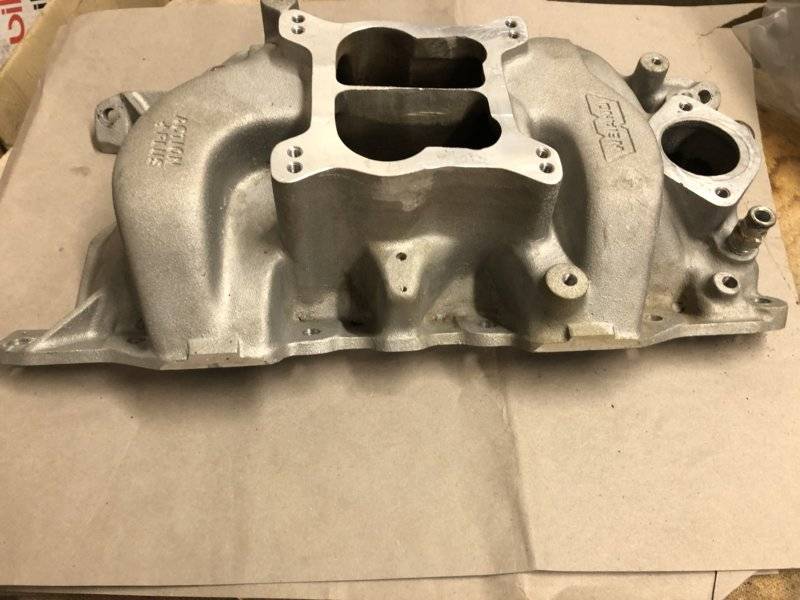

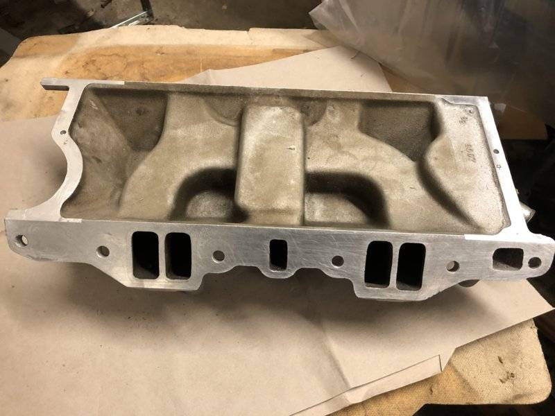

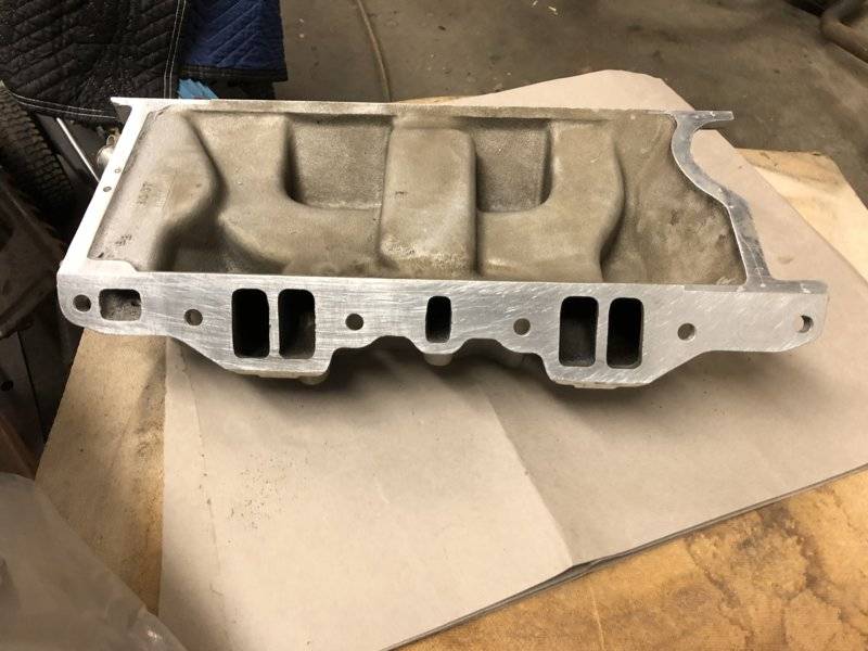

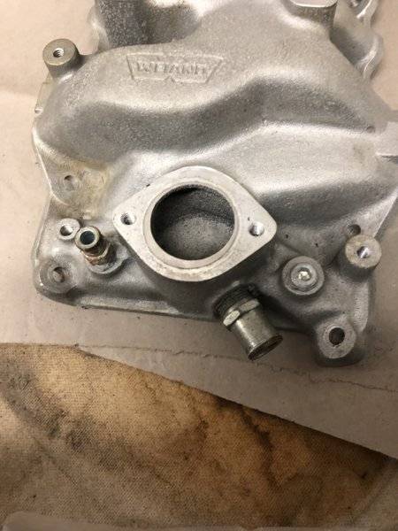

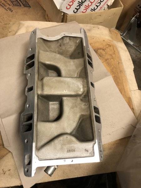

Looking for a used intake in decent shape to convert my old truck from 2-bbl to 4-bbl; Edelbrock Performer or Performer RPM or a Weiand Action Plus or Stealth or similar.

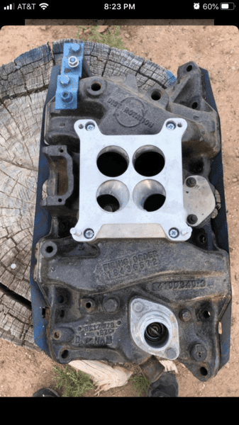

I’ve got a cast thermoquad intake you can have for 10$ plus shipping. It’s got a new thermostat housing, thermostat and spread to square adapter. Pm me if interested.
