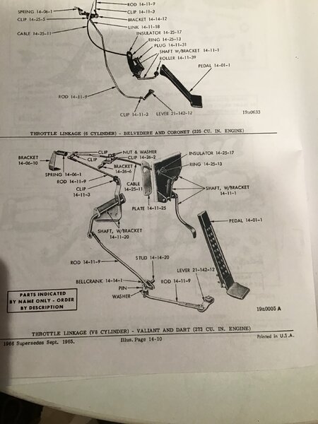

Looks like this I have a few parts for the setup
My daughter is sick today so I probably won’t get the measurements today. Attached is a drawing showing what you need. I made a mistake in my earlier post. All parts are same with 2bbl or 4bbl EXCEPT the following.
Bell crank to carb. 2bbl part # 2532-595
4bbl part# 2536-296
Throttle cable bracket. 2bbl. #2465-604
4 bbl# 2465-986
Throttle cable is the same
The bell crank bolted to the engine is apparently different also.
2bbl. # 2532-596
4 bbl. #2536-297.
Hope this helps.

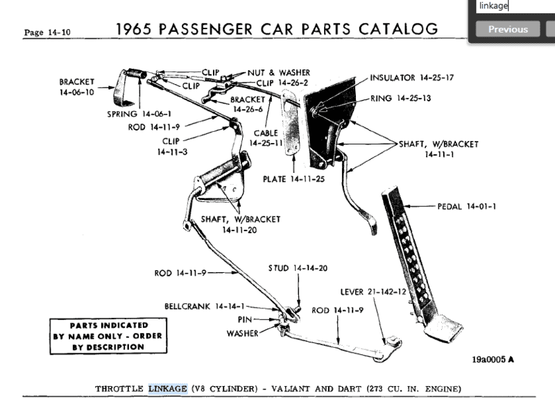

Diagram from the 65 is mostly identical

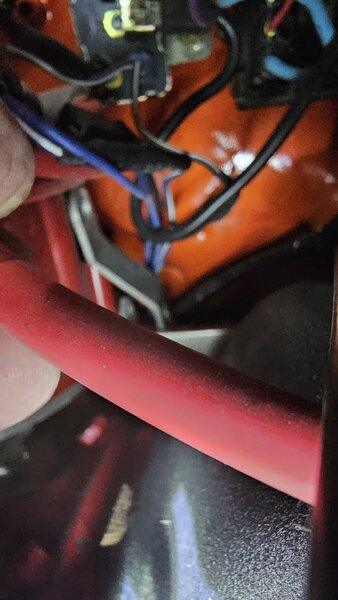

Sorry all for the delay. I was traveling for business and then the shop owner was away at a car show (lucky guy!). Here are some pics of what I have. It looks like we have the long shaft that goes to the transmission - that is a victory. Unless we need a different shaft because I converted it to a 4-bbl. I don't know the ins-and-outs of these details. Hopefully, one of you can guide me. I also have pics of the carburetor/accelerator linkage on another thread for those who are interested.
Looks like you have the 2bbl bell crank and missing the forward rod that snaps onto the outside ball of the carb stud. I can't see enough detail on the accelerator cable and it's mount to see if it's correct or not. From the bell crank down to the transmission uses the same parts whether 2bbl or 4bbl.
Here are pics of the accelerator linkage that I have.

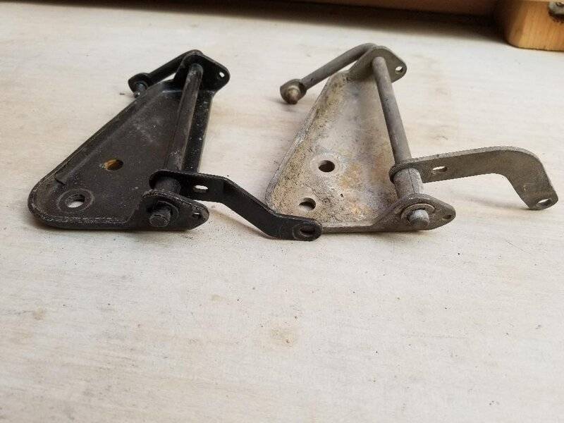

Hey 69FBCuda, can you tell me which is the 4bbl and which is the 2bbl in this pic?
The one on the left is a 2bbl bell crank. The one on the right is a '65 4bbl one. '66 4bbl is different....more offset to the driver's side with the upper/forward section.
