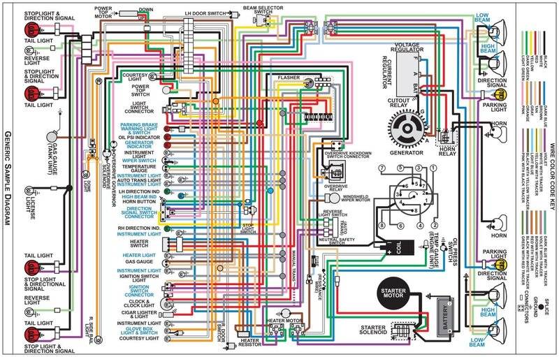

That actually makes a lot more sense so do you think it can be a short along the ammeter wires causing the problem? I drove the car it worked fine with the way they were hooked up then nothing after that. No ignition no lights nothing. It gradually got worse it would pop the fuse once a week then daily then after every drive now it pops the moment I hook it up. And could anyone tell me where on this diagram the ammeter would be?

It says "Generator Indicator" right under the Oil PSI Indicator...
If you trace the BIG RED alternator charge wire from the alternator all the way to the ammeter, then THROUGH the ammeter and the "other" side, including the "factory welded splice" you will likely find where the problem is. It is simply a matter of physically tracking it down.
You need THE diagram for YOUR car. That one is a "generic" example AND most likely a Ford based on the voltage regulator call-out.
Yes, I agree. Notice also it says "starter solenoid" which is also Ford speak. A Chrysler diagram would say "starter relay". Their little alternator picture does look somewhat "Chrysler-ish" though, doesn't it? LOL

The black is a major main feed FROM the ammeter and goes "generally" to the headlight switch, to the fuse box "hot" buss, to the input terminal of the ignition switch, AND OUT THE BULKHEAD AGAIN to the ALTERNATOR
