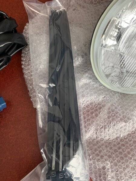

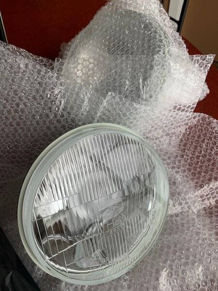

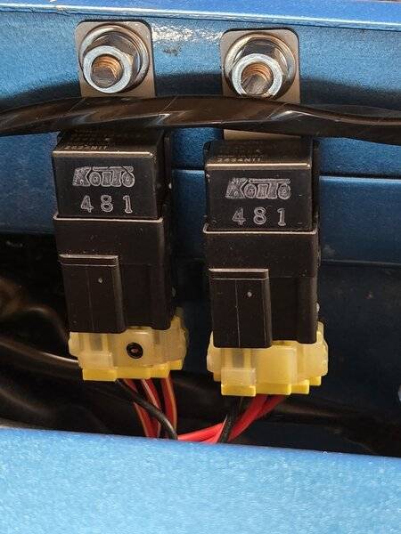

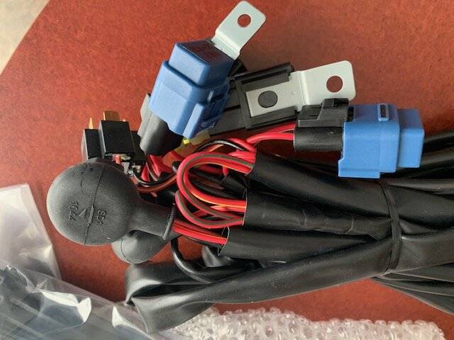

Here is the Toyota headlight kit...screaming deal for $30.
I started looking at the headlight relays. I see people have used the Toyota headlight assembly kit - 2 headlights and a harness with relays....$31 Cdn! The parts guy at Toyota even told me what a steal of a deal it was. I ordered one so we'll see what it looks like:
Genuine Toyota headlight kit made in Japan that works with the FJ60 and BJ60 Toyota Land Cruisers. This kit allows you to replace your sealed beam headlights with halogen headlights with replaceable bulbs. Kit includes:
- Pair of Headlamp Glass Lens
- With Bulbs
- Wiring Harness
- Zip Ties
- Instructions
OEM; Made in Japan.
I bought this kit not long ago, it works really well, and cheap too!! We were talking about it last year back in this thread here:
Headlight Question
I used the relay kit that they provided cause although I want a kit from Crackedback, its just not cost effective with the exchange rate atm. Of course the light output is WAY better now!
