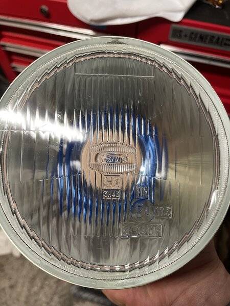

Interesting thread on another forum: It appears ordering part number 81110-60p70 from a Toyota dealership gets you two Japanese-made Koito 7" H4 headlamps plus wiring and a relay setup for around $20. It's sold as a conversion for older Land Cruisers. No idea on how their beam pattern compares.

E code is euro spec, and for us or our "type" of headlamps, it is basically the "pattern" and means it has a sharp cutoff line for the low beam. the number is the origin or approval code for the country.
and provided your E code headlamps are for LHD countries you are good
remember Japan is a RHD country like UK Australia india and NZ
so provided the kit for the land cruiser is US equipment all will be fine
if its NOS japanese or Australian. i believe the pattern in the lens will try to defeat your attempts to get a good cut off.
some lens patterns cover both.... but we are talking new new stuff...mainly
here are the E mark designations
just make sure the country code is LHD like the US

The headlights in that Toyota kit are E codes. E6.

Interesting. I wonder if those are the same Kioto lamps that sell for much more. @slantsixdan - what do you think about these lamps?
That's a screamin' deal on a solid pair of lamps and harness. They're ECE (Europe/rest of the world), not DOT, so if that matters to you or the authorities where you live, that would be a dealbreaker. Otherwise, pounce and enjoy. Aim per VOL specs at aim page.
@MadScientistMat, thanks for the Toyota light tip! I ordered three sets, hoping this was for real. I'm happy to report it is, I just got back from the local dealer with my lights. With tax they were just a whisker over $20 per set - which I consider almost free. They look excellent, the wiring harness is heavy duty, and it even comes with a fistful of zip ties to keep the new wiring neat.
I saw in one ad where it said they ARE DOT approved, but I know better. LOL I'm tempted to get a kit "just because", even though I have Seebees (LOL) and relay harness in my truck and Valiant.
Two real good reasons to disbelieve that claim:
1. There's no such thing as "DOT approved" — it sounds all official-like, but it is a meaningless phrase. US and Canadian vehicle safety regs do not work on an approval basis; the DOT does not approve equipment. Whoever claims a car part is "DOT approved" is lying, ignorant, or both.
2. These lamps are not DOT-certified.

I'll give this a shot.
The markings on the lens are based on the manufacturer certifying that they meet the requirements those marking represent.
A responsible manufacturer will of course test to insure they comply with the standard claimed. When I worked at company making a safety product going into cars, we had an independent company do a number of the tests for us. But they got paid by us.
An irresponsible manufacturer can have whatever they want molded into the lens...
SAE sets industry standards.
The Federal Motor Vehicle Code sets requirements for new vehicles (and many states refer to the FMVSS 108 for vehicles operated on their roads).
Neither the SAE or the Feds conduct certification or approval.
