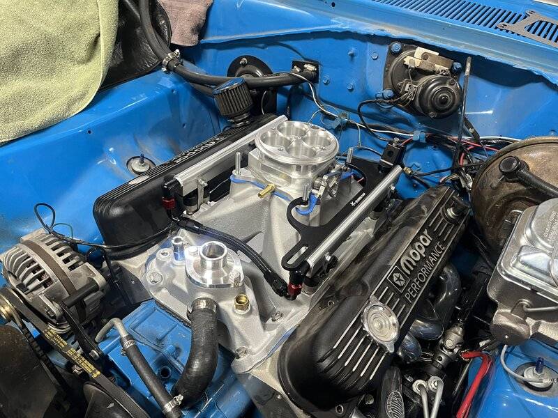

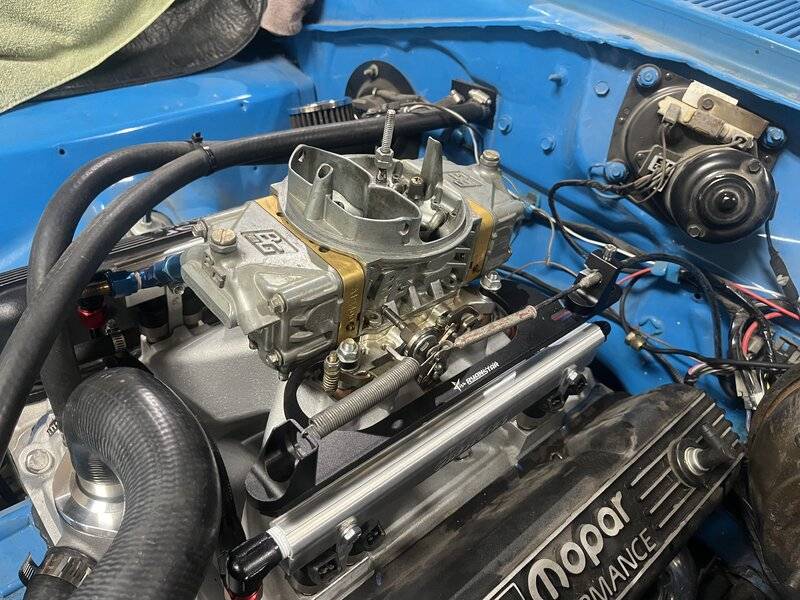

I decided to put the EFI intake on before I put antifreeze in the engine. I plan on breaking the engine in with a carburetor, driving it for awhile, then swap it over to EFI. I really hope to have it fired up this weekend!
I may have missed it, but what kind of EFI are you going with?

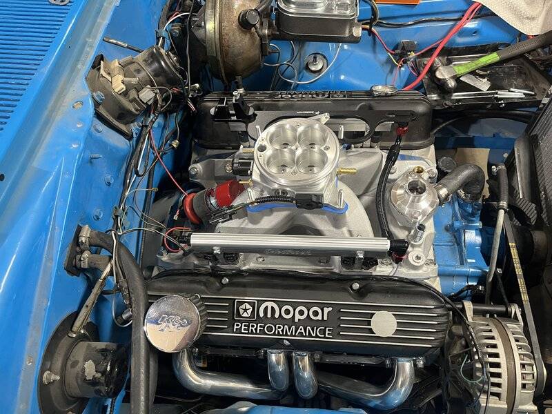

The intake is a Chinese knock-off of a Super Victor EFI (I believe ACES now sells the intake) Speedmaster 4150 throttle body, summit 30lbs injectors, Holley Terminator X will control the electronics along with a Holley Dual Snyc distributior. Tanks Inc EFI tank with Walbro 255l pump inside will supply the fuel.
Oh were you the one that got the trade show intake? I saw a lot about that one. Looks like it will be a nice setup. I'm thinking about doing something similar.
Like I said ACES now sells this exact intake, but they’ve got the price jacked up so high it would almost be worthwhile buying the genuine Edelbrock intake

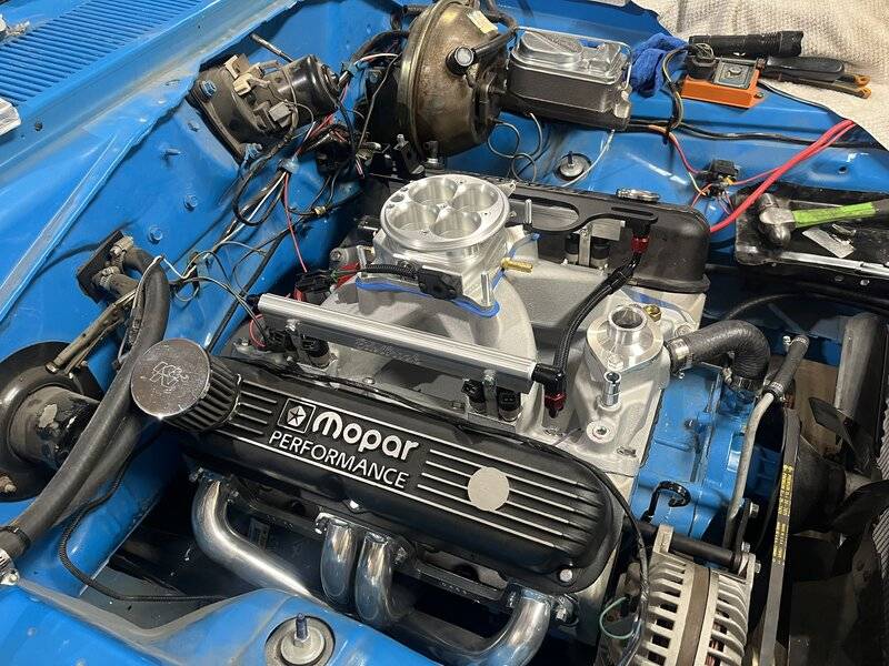

I had to go with a aftermarket throttle cable bracket, because the intake is so tall. It required a few modifications, but it seems to work fine. The plan is to prime the oil pump and hopefully fire this thing up this weekend!
