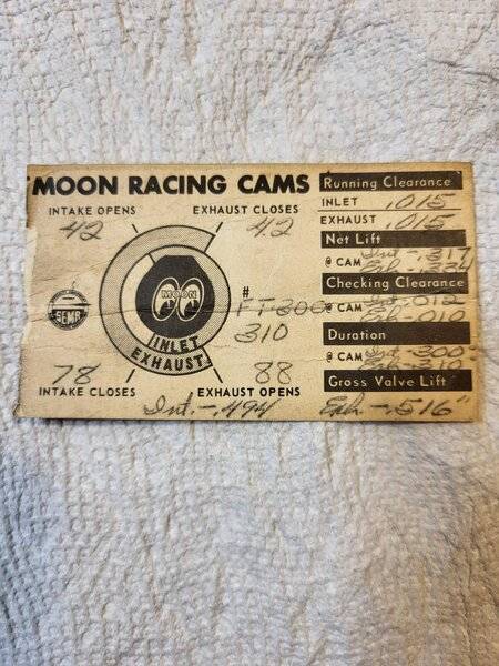

I ran across this today in the garage.
This was a Clifford cam from years ago.
Moon cam came in the box!

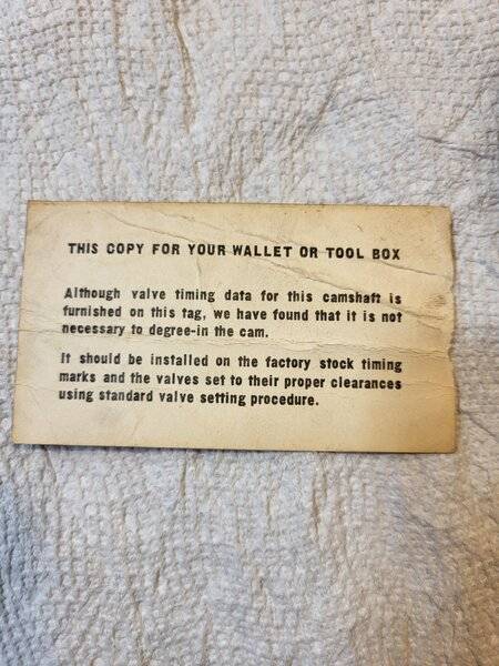

Note the last picture of the back of the cam card.
Thanks Rusty.
It ran real good.
I sent it to oregon cams and had it reground for the Lancer.
Big mistake, wish I had it back.
That cam was the one that I went 13.49 in the Barracuda.
