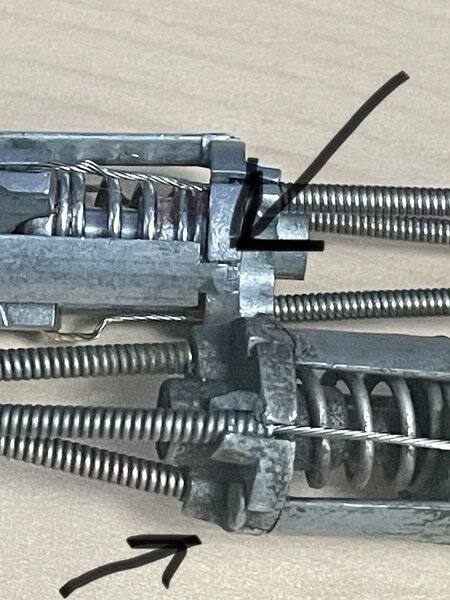

1, installed the mirror and noticed the control lever movement doesn’t relate to the mirror movement. Compared to the original- the red, green, yellow cables are crimped into the wrong locations.
2, After opening/closing the door a few times, at one point I noticed the control “joystick” seemed to be gone, yet the bezel ring was still in place. WTF? Turns out, not enough material for them to peen the pot metal to hold it together. Pictured compared to original.

I went to adjust mirror and heard POP, and joystick stuck in down position. One of the cables came un-crimped from the slug that holds it in the adjuster.
Original works perfectly for 55 years, just looks like crap. Guess I’m going to try to put original parts into new chrome housing, worst case, it becomes a manual adjust or fixed position.

Im hoping, but I’ll have to open the pot metal to get ghe cable ends out of the adjuster, and another pot metal joint for the cable housing times 3 cables take it apart, thread it all in the new housing then put all 6 joints back together.
Im gonna give it a go, but my track record with small pot metal stuff ain’t all that great

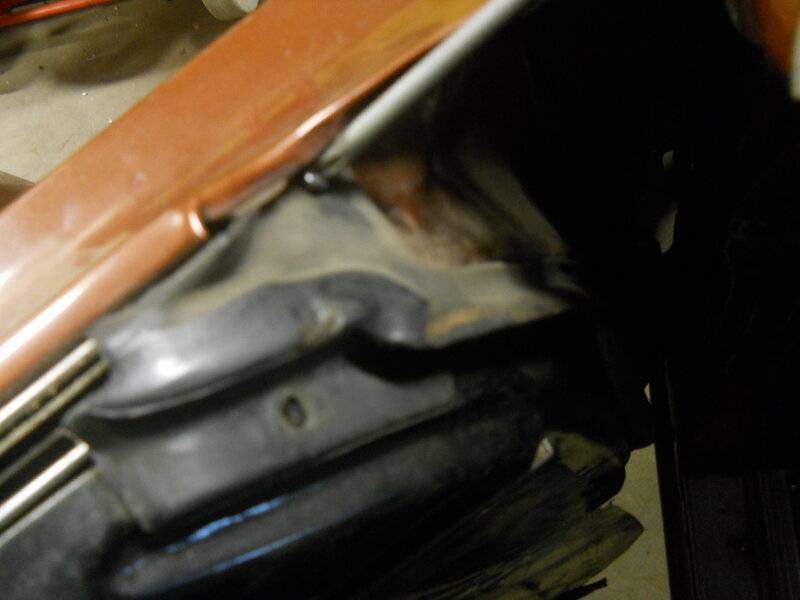

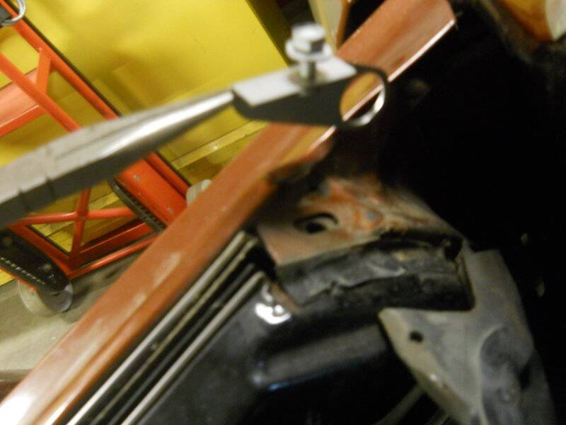

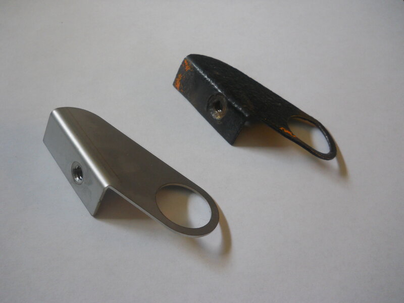

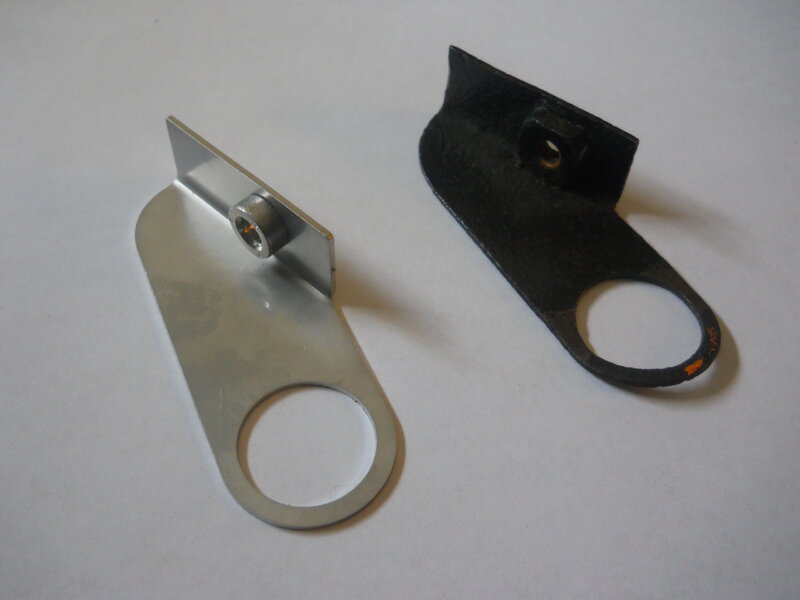

There is a clip that goes inside the door to hold the cables away from the glass as it goes up & down also. It may not be in all A body doors, but it needs to be in Duster/Demon/Sport doors with remote drivers mirrors. I would say it is needed to keep the door glass from jerking the cables out of the mirror or control. Steve, @Oldmanmopar did a post about it on here several years ago.
I had exactly the same problem with my original one.
15 min JB weld and zip ties fixed it,
Also only move the pot metal as much as absolutely needed.
Thanks, I’m assuming it’s needed for single piece side glass (cars without vent windows)?
Believe so. None of my vent window cars have or need that, since the back of the vent window frame goes way down into the door, and the mirror cable is in front of that.

Same problem with my remote, everything is *** backwards. The fixed one on the passenger moves every time the door is closed. May try some blue locktite on that . Chinisium.
