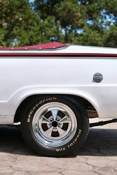

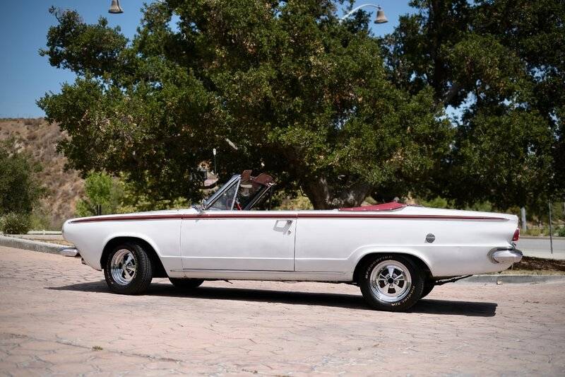

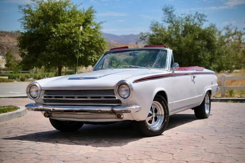

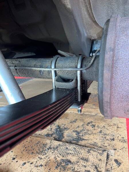

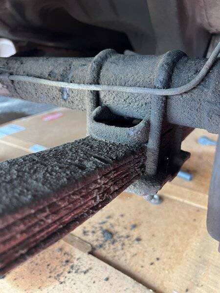

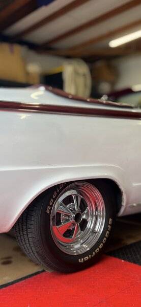

Greetings all,
I know that when I was trying to answer that all too important question: “Stock or +1”” when ordering Espo leaf springs, I wanted more and more photos.
I’m here to give back a little. I just installed 6-leaf +1” springs on my ‘64 convertible GT. I think they turned out great. Ride is much better.
The ones I replaced, I’m pretty darn sure we’re original.
Now front suspension…
Happy wrenching,
Greg
Thanks Rusty.
One thing to add for those looking for reference photos… 14” wheels up front, 15” in the back.

That looks perfect. It has just a little rake that looks great on these cars. ESPO is a great place with friendly staff and reasonable prices. We have sold hundreds of sets for them here on FABO.

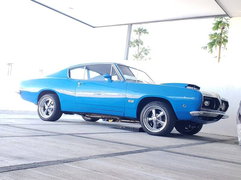

I have considered changing the stock "sport" leaf srpings on my barracuda, they are pretty stiff on rogh roads. Just rebent them to their original arch when I got the car and have been there since. I considered the hotchkis 2-leaf spring, but do not like the idea of lowering it. I want stock height and good performance.

Thank you for this ! Your pictures helped me decide
That looks great... i have +1 on my car but havne't had it off jackstands yet.. i can barely push down the rear end which is worrying, waiting to see how it drives...
Give it some time, they will loosen up. Be sure to loosen the rear shackle nuts, put the car on the ground and then tighten to specs. Often need to repeat that process after a few thousand miles. You are avoiding having the rubber bushings loaded/twisted leading to premature failure.
