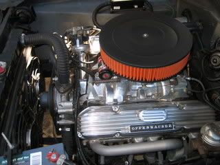

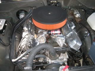

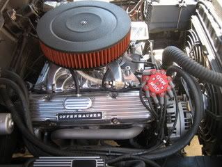

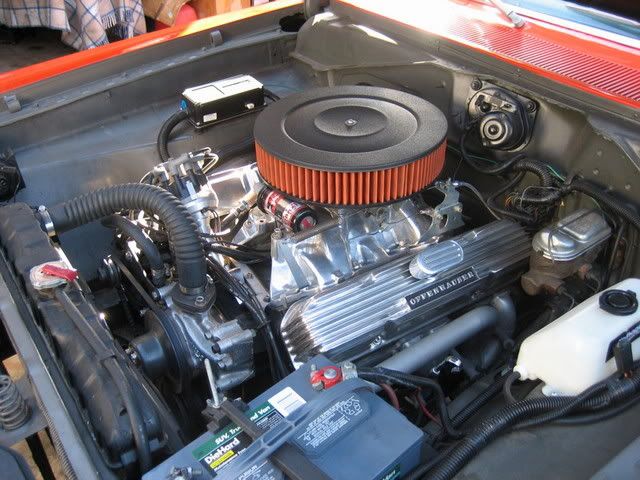

Here's some pics of my engine in the Dart. Hope it helps:
Those Valve Covers look outstanding. Like a 1930s air craft engine of some sorts. That whole motor and that matte black breather looks great.
