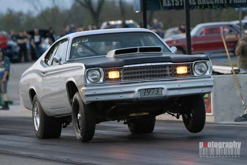

Here is picture that our track photographer took a few weeks ago. It's a screenshot because I don't do social media.
Looks like that is getting it done. Any work on the heads and intake or are they still as issued?
