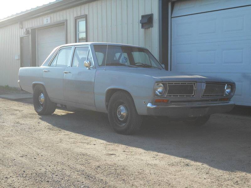

I bought this turd with the sleeper vibe in mind. Aluminum head 360 with solid roller, PTC converter in front of a 904 with Ford 8.8 and drag radials
