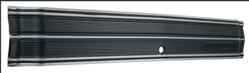

Several sites offer an aftermarket 1969 Dodge Dart GTS Rear Trunk Lid Panel Molding. This requires you to then purchase the GTS emblem to be applied. These are not like the original where the emblem appears molded in the panel. Any one purchase these? What is the quality? How is the GTS emblem applied? If I cannot find an original, I may have to go this route.

The repop seems to be a bit thinner than the original but looks really good. The clips that hold it on are not with it so you have to source them too.
If your trunklid doesn’t have mounting holes, rather than poking holes in your sheet metal, Im sure 3M moulding & emblem tape would work.
Oh, and same stuff for the GTS emblem
The reproduction panels look correct in every way except the rectangle on the lower right where the Dodge GTS emblem plate is mounted. On the original panels that rectangle frame is not black.
