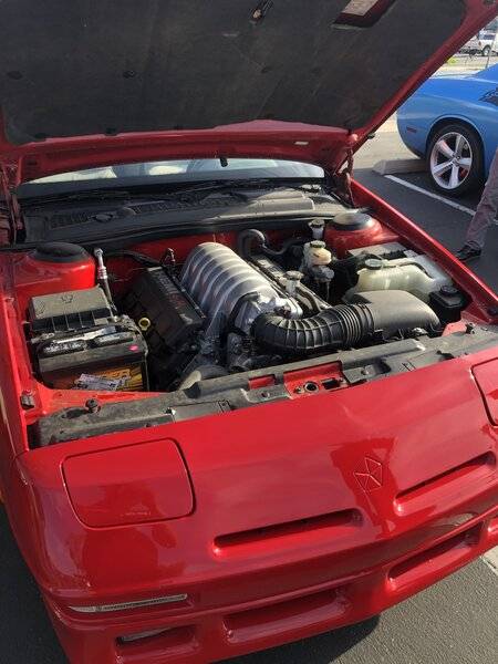

Not my car but this is a dodge shadow with 6.1, I’m pretty sure he is a member here.
