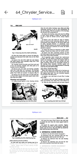

Hi, I have a 75 duster and I'm putting in a 440 with a 727 trans and the rear is a 7 1/4. I just picked up a 8 3/4 from a 64 polara with tapered axles for free. I plan on doing the conversion where you separate the drum from the hub for easier brake work. I got the axles out and plan on changing the center chunk gasket due to a leak. I can't find any info on how they go back together or what gaskets go in the housing. I tried a manual I found online but it didn't get into any detail. Any help or guidance would be greatly appreciated!
Thanks
Dan
Service Manuals – MyMopar
towards the bottom 64 chrysler

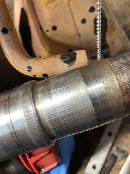

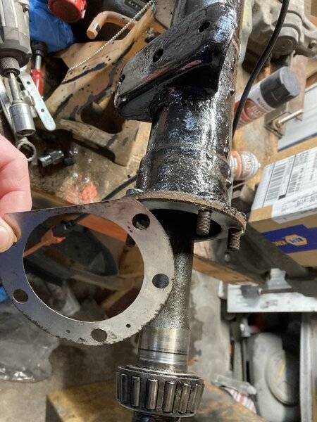

Hi guys, I took the axles out and removed the bearing. I was able to get the #s off the old seals. I don't see any shims. Check pics,
Do you have to press in the race over the axle bearing as you put the axle in? Is that what holds the axle in place?
