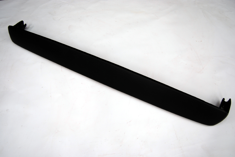

Tried to re-cover a dash pad with new vinyl didn't work at all for me never could get the vinyl to wrap right, bought a hard cover from a member on here for my moms duster, was not happy with the look of the hard cover at all, flipped it on here made my money back. My dart got a brand new Re-pop from B e and A mopar and I could not be any happier with it! My buddy had a 1973 swinger he had a shop re-make a Dash pad and they made it like 4 inches smaller width wise, it looked decent but funky. Take your time and way in cost over look at decide what you really want instead of loosing money in the end...
repro's are available now. I used a cap on my Dart
B/E A parts $225 Dollars fits like an original one.
I just has my dash pad repaired and painted. It was in decent shape with just a couples cracks around the corners. Cost me $125 and looks good. The grain is impossible to reproduce like new, but my guy did a nice job. I'd you have a good core, it can be repaired.
I put one on a challenger & a 68 dart I used a lot of plastic clamps, & used the glue that was sent w/ it, only around the edges,if you push & pull right you wont be able to notice that its a cap, they fit very well
