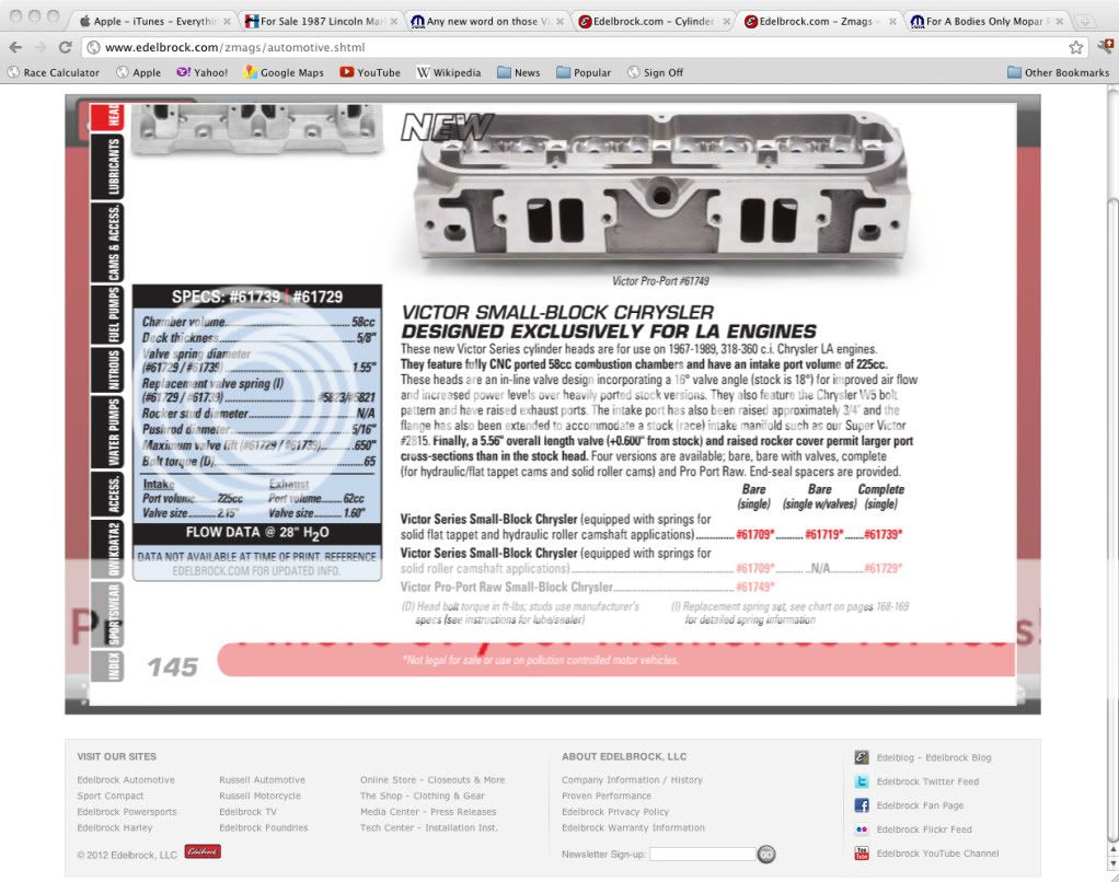

there's a pic of the heads on page 145 in the downloadable catalog on the new products page. There is some weird text about the intake ports being raised to where you need a race intake, "Like the super victor 2815", but the text for the super victor says it fits conventional small block mopar heads.
Its mopar hot rod parts, so you know its vaporware until you actually see them in person, but it at least has the potential to be cool.
EDIT: The listing also says it has the Mopar W5 bolt pattern (I assume they mean exhaust bolts?), so that kinda sucks.

dont worry about the raised intake ports,they have done the same trick as they did on the bigblock victorheads,they raise the ports and make the intakeflange on the head thicker so that a stock type intake still fits instead of needing a dedicated intake,you just put spacers betwen the endrails on the block and the manifold to take out the diference in height and to be able to seal the engine,there is no rocketscience to it realy8) as for the supervictor intake they recomend,the reason is that with the raised port you may end up with a slightly diferent port floor and roof angle and they probably designed the supervictor with these heads in mind,with runners exiting at a slightly diferent angle for better flow and a straighter shot at the valve.
hey now the W5 exhaustside doesnt suck its a big improvment,ever tried to squese in some desent primarytubes betwen the narrow and stupidly located exhaustbolts on stocktype head?

Here's the catalog page I referenced in the above post:
Looks like there's a typo on that flow chart on the webpage for the Victors. Couple that with the listing big block twice instead of small block and its obvious QC at edelbrock is sky high these days.
