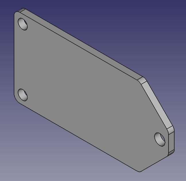

I'm using a stock exhaust manifold with a Clifford intake manifold on my turbo project. I blocked off the heat riser with a piece of 1/8" sheet metal, but it looks like that wasn't thick enough. It warped and leaked
So I'm getting a new block off made from 1/4" plate.
Would anyone else be interested? If so, I could get extras made and the price would be $20 plus shipping, maybe less if there was a lot of orders. This would not fit intake manifolds that bolt to the stock exhaust manifold riser, only ones like the Clifford that don't.
I would be interested. I am doing stock exhaust manifold and Clifford this fall and was going to make one myself.
Pm me if you get enough interest to make it worthwhile. If you don’t get enough interest, I’ll take a dimensioned CAD drawing if you can share?

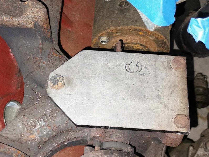

RGAZ
First one, I got the math a bit off and it was an inch too long. I'll cut this one down and make sure it works on my Dart, then get some correct-sized ones on order.
