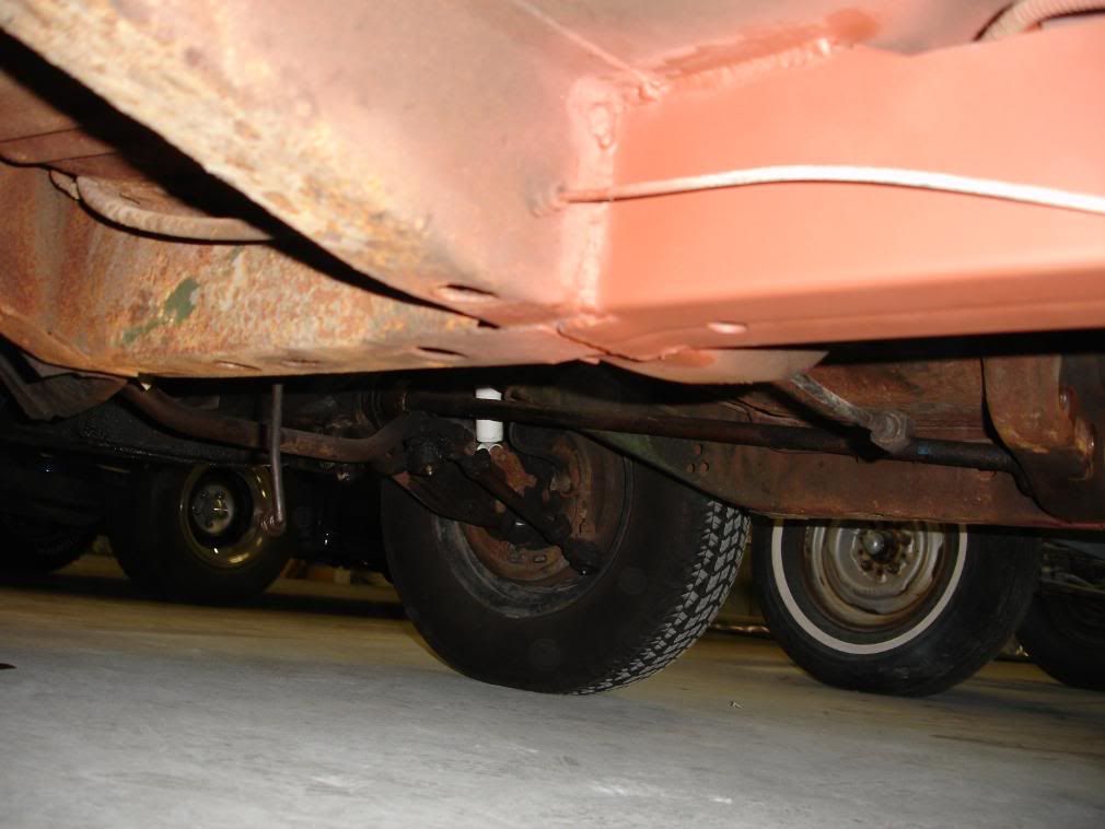

I am in the process of installing my frame connectors from US Cartool. The only issue I am having besides a little trimming and grinding is figuring out how to route e-brake cable. Does anyone have pics of their install with the e-brake cable ran. Or can you tell me what you did? I know the instructions say drill 3/4" hole and route that way but it just seems like a heck of a bend and constant rubbing?
I think the cable crosses at an angle like l/l
So to hole saw from both sides at 3/4" diameter should allow the cable to run where it always has plus the staggered hole locations doesn't weaken the rail as much as straight through.
Here they are installed...I didnt drill the hole for the parking brake cable yet.
