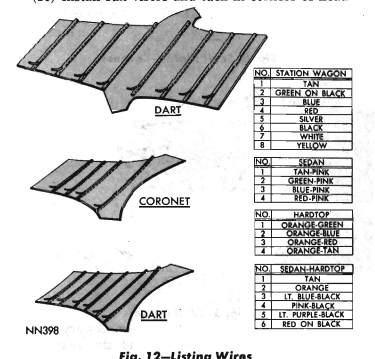

Memyfofum Member Joined Mar 27, 2022 Messages 6 Reaction score 1 Location California Mar 27, 2022 #1 I have a 63 dart gt and I need the headliner bows, there’s someone near me selling a set off a 64 cuda so I’m wondering if they’ll fit or if there’s any other bows that would work. Any help would be appreciated

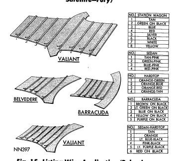

mopowers Well-Known Member Joined Feb 15, 2006 Messages 8,642 Reaction score 4,850 Location West Sacramento, CA Apr 4, 2022 #3 I'd bet they won't work. Early Barracuda's have 5 listing wires, while early Darts have 6. These are from 66 FSM's, but you get the idea.
