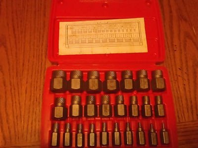

It would depend on where it is broke. I have seen studs broke at the top so I have just used ViceGrips to unscrew it. I have a set of Matco extractors that work well in most cases. I hate the square extractors because I have had them break too often.

i couldnt be so lucky to have the stud broke at the ttop lol, No its broke in half clear down in the bolt hole of the head. maybe i will look into some extractors...

This is the set of extractors I have.
ok, i also checked what is called a bolt extractor, it keeps you straight while drilling out the broken bolt/stud. I will get the intake valve seals changed as soon as i can and see what happens. I sure hope it works because i dont wanna spend the money on new heads ether, but i also dont wanna spend alot chasing down whatever it is. But at least i have limited it down to ether guides or seals, i just dont see it being an internal vaccum leak when i have 18 inches of vaccum a idle. unless it should be generating more vaccum, but i thought 18 was plenty of vaccum at idle.
