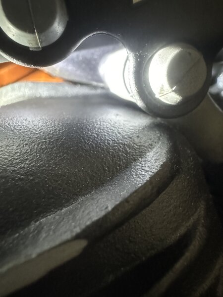

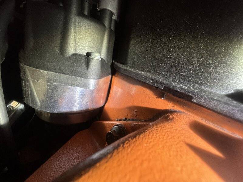

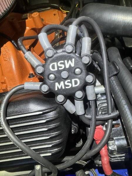

I have had both the new small cap and the original larger cap installed. The larger cap was definitely a pain to deal with. Had to pull distributor to get valve cover off. The small cap I did have to clearance the valve cover lip, most of the edge lip that is vertical to valve cover gasket. I am running Edelbrock aluminum heads. I had previously made clearance for a Mopar style electronic distributor so I can’t attest to the head. If I get to the shop tomorrow I will get you some close up pics of the area. As far as the distributor itself I absolutely like it. Been no issues. My car is primarily street and the MSD setup would get hot due to not getting out of the multi spark rpm and go stupid on me.

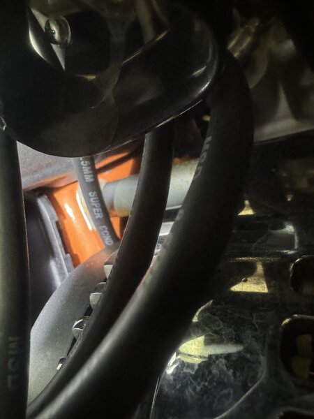

The height is close to the same on shaft housing length, the difference is in the area where the electronics are installed/cap mount. I had to clearance the head also. As you can see hopefully. Sucks having to grind on a cylinder head but I’ve been running for over 6 years and not an issue with it. Correct on terminals also be aware they call for a specific coil resistance range also. I believe any “stock” type distributor will interfere, at least on the Edelbrocks I have.
Thanks for the pics! When I get my engine back together I may get that distributor and see what needs to be done to make it fit. I talked with Ted yesterday at PI and he said he would allow me to return the distributor if it did not fit, even if I mod the distributor. Seems like a great guy to work with.
