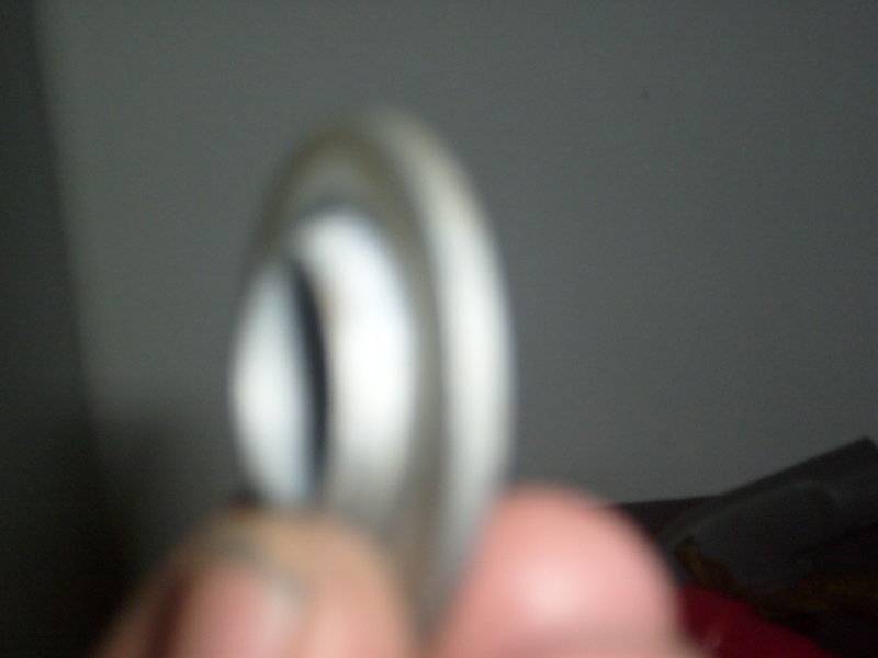

Close up of the special washer I used on the front QA1 mount

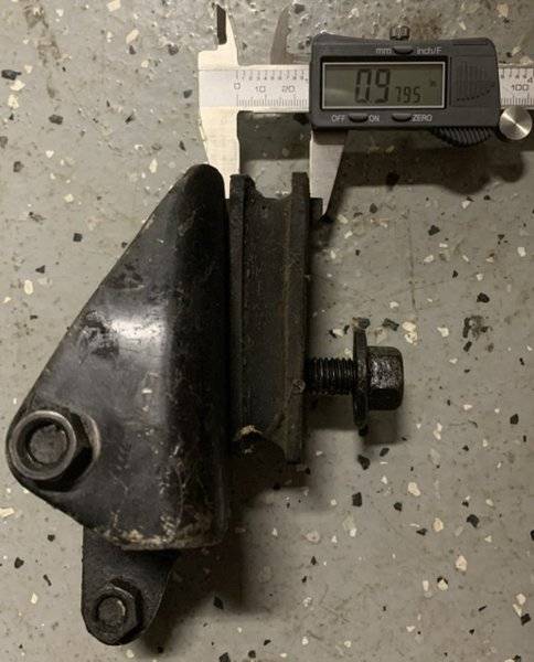

Maybe some pictures will help.
This is a 67-72 style K frame mount
And this is a '67-72 engine mount, a "biscuit" style mount. The rubber block sits flat on the K frame and the mount ears go to the engine.
This is a 73+ style K frame
And this is a 73+ engine mount, it's a "spool" style mount. A bolt goes through that bushing, and then sits horizontally in the notches on the K frame mount. The ears on the upper mount attach to the engine the same way
21
I'm about to install a QA1 K on my 72' Scamp, so I need this explained to me like I am 5 years old (just ask my wife).
So this special washer essentially centers the mounting tube of the K-member to the frame rail, correct? Will I still need to 'square' the K-member when installing it, or does this washer take the guess-work out?
How many washers do I need?
Lastly, is the Part # of the washer 68401387AA ?
Here is the part diagram I found for a 2020 Ram PS rack.
You will need two of those PNs to get the two for the front. the rear I used large thick washer from any hardware store along with matching flange bolts . Only reason I ended up with those ram washers was wa had a run of bad electric PS racks at one time and the replacement rack had extra mounting hardware , so those machined washers were all over the place for a while .
