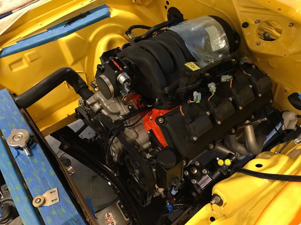

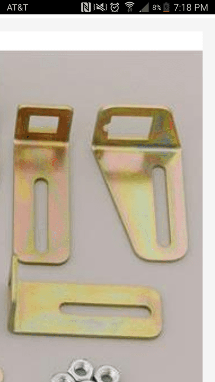

No no.... I will try to better illustrate monday from the office, but...you take (or make) a little 90 degree bracket, and install it with the same bolt that front heater hose is using. You then can mount the throttle cable to that bracket. The way that bbk tb wraps kind of down AND back...you have no problems getting WOT. Idk how great the dyno pic will blow up...but we r using it there.
This is the best image i have. This is literally one of the zinc brackets above with some mild filing, mounted to that heater hose hole. (facing backwards) the way the Tb sits, and the fact it wraps downward, and back" we get perfect WOT with this.
That super simple, and under the intake is a bonus! Thanks for sharing
