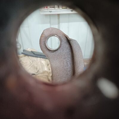

Today I was attempting to remove bushing shells from an upper control arm and I got a little careless, and might have bent one of the "ears" holding the bushing just a little bit. Is it toast? Can it be fixed by a automotive machine shop. Can the front alignment process compensate for this?
A picture won't show anything. If it's bent, it's just a little, and a picture won't show it.
Best way I can describe it: if you look down one hole to the other hole, you can see they are not perfectly aligned. Just a wee bit off. Nothing drastic.

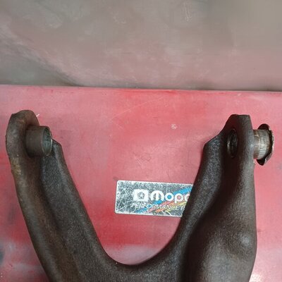

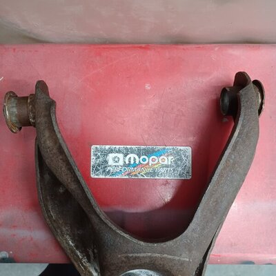

Looks like he just removed the rubber from the shells to me
The one shell is pressed about half way out and appears to be at an angle to the shoulder that locates it.
Could just be the shell is tweaked. But I'm not there and he thinks the whole arm is bent, so he can figure it out.
