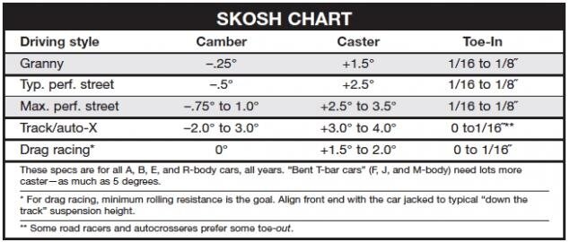

well you really don't want the alignment in the "green" those are shitty stock specs on the machine.
These guys have it right, “in the red” doesn’t mean anything at all unless we know what specs the shop is trying to set the alignment to. If their computer has stock alignment specs in it, the alignment you want would be “in the red”.
And as others have already said, Moog offset bushings are good enough for most average street going cars to get to decent numbers.
Do you have a print out of what you’re at now? This is what you want…
