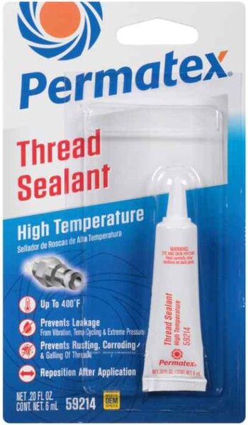

Unless there's any objections I plan on using Permatex 592 thread sealant.
What's the difference between these two? One is what Permatex has on their site, the other is what Canada Tire sells. Different Permatex P/N ?
I tried some of this thread sealer stuff on a relatively new nut and bolt. After 24 hours, the stuff that was exposed was still soft, same as it came out of the tube. But the stuff that was on the threads must have cured - I can't twist the nut by hand. So I guess it does work...
Did u find out the difference between the 2 Permatex? I'll chk which # I have when I get home.
I think 59234 is the P/N for 50 ml tube, and 59206 is P/N for 6 ml tube. Same stuff otherwise. Both are likely Canada-only P/N's.
