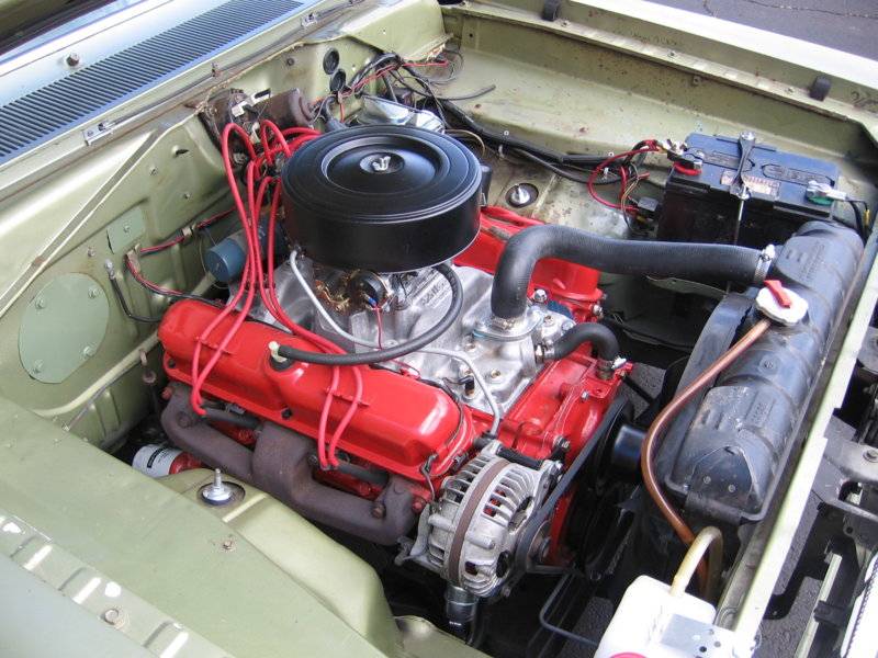

I need to know where the vent attaches. We need a source for the hoses for the valve cover to air bowl and the passenger VC. I thought we took pics but I cannot find em!!!!
Also if some one has pics of how the factory metal tabs hold the wires on the front of the VC behind the alternaoter. I'm a Ford guy and I have no idea!!!!!!!!!!!!
I'll tell ya the torqflite tranny linkage to the carb on these cars is nuts!
This is from my 68 Valiant,Hope it helps
The drivers VC is like yours. It goes to the airbowl. The passenger which I believe is the PCV valve goes? I cannot figure where it attaches. I have a stock 2 barrel carb
OK another look when it was a stock 2 bbl.Looks like the PCV went to the back of the carb. Some BBD's the port is at the front.
