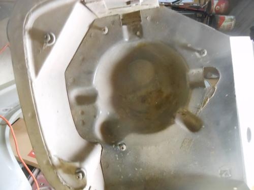

66 dart, I just did the headlight harness upgrade. The PO has used drywall screws to attach the headlight bezels. I see there are some square cut outs that must have held some sort of clip or insert that the screws are supposed to go it. Any idea what or where these can be found? OR what they are called?
thanks
Don't know the actual name but they were nylon and pushed in.
Then the screw went into them.
Try R/T specialties . They have a lot of that stuff. actually their just a square molly .
Here are 2 pics from my fender off my 66 Dart. I can get better pics if you want more just let me know. The fender is laying on its side on a stand so the parts you are looking for are the 2 on the left in the pic and the screws are in them.

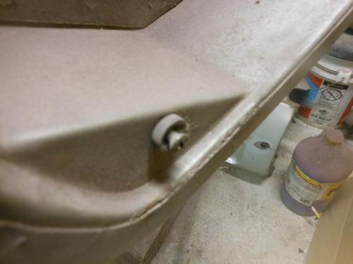

and to add to his pictures
this is what fits into your holes
they are bezel spacers and r/t specialties does "seem" to have them (I had to file mine down a lot to get the headlight bezel to fit flush to the fender ) But these that I found were exactly the same height as the originals except in off white instead of black.
