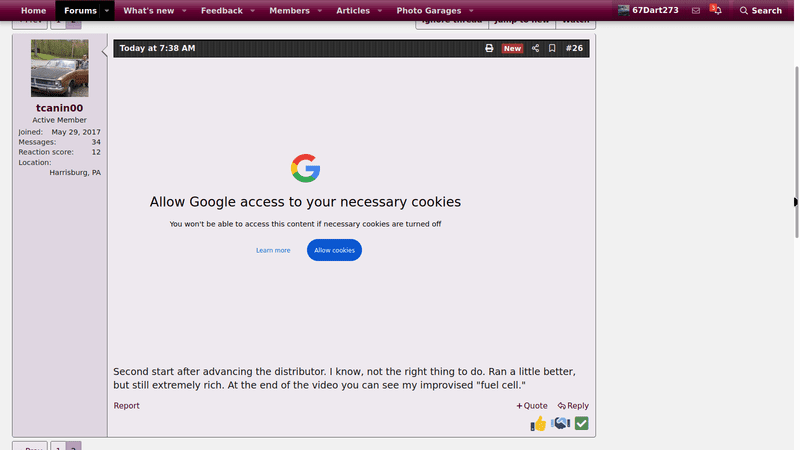

Second start after advancing the distributor. I know, not the right thing to do. Ran a little better, but still extremely rich. At the end of the video you can see my improvised "fuel cell."
What in the Gargoyle is this??
The answer is, !!!!NO!!!! I am NOT going to allow "Google" to have access to "necessary cookies!!!!"
I'm not sure what's going on with that. I uploaded the videos to Google Docs so I could post them. Was it both videos, or just the second?
It’s both. Load em to you tube and post a link.
