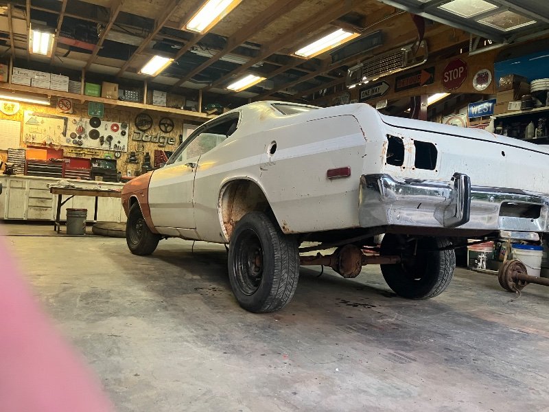

I did this 3 weeks ago just for fun.
I didn't weld anything, I just cut the perches off and put them on top of the axle, bolted it back up and took pictures.
SUPER rake.
Now with the torsion bar screws maxxed out:
It looks silly but hey...I just was messing around for fun. I never measured anything but it is more than 3 inches taller. When doing a FLIP, you add the thickness of the spring pack to the diameter of the axle to get the total amount of difference in height.
Most 1/2 ton trucks with a flip kit are in the 6 inch range. This looks at least 5 inches higher in back.
SUPER rake.
Air shocks will do pretty much the same thing....and much easier.
The leaf spring/shock plates had to be switched. Left side to the right, right side to the left. This is because they are now mounted upside down so the shock stud needs to be to the inside of the spring. This puts the shock at an extreme angle. It isn't ideal. If one were to care enough, a dropped down shock mount would be much better.

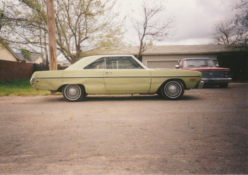

I did this same thing 28 years ago to a 73 Swinger...
Before:
After.
Before:
After.
Were you offroading it?
Ha...
No. Then, just like now...I like to mess around with this stuff just to see how it looks, how it performs and such.
I was just having fun. That green Dart just got a flip with some home made brackets. My brother owned the car, I did this when he wasn't at the house.
He came home and dang near busted a gut laughing at it.
Later he was out driving it and one of the brackets shifted and the axle was moving around. He told me he was in a parking lot for hours reversing the flip to put it back to stock, then he lowered the front to below stock. He kept tools in the trunk but no jack stands. Imagine doing the flip reversal with just a floor jack!
It only looked like this for a few days.

I agree, the air shock route would be easier but I'm told the upper shock supports are not too beefy. The ride gets real stiff with enough air to lift the car this high. The axle flip is obnoxious but the ride stays similar since the spring rate is unchanged. The white Dart Lite had a 7 1/4" axle that I pulled out and sold. I stuffed a 2.76 axle back in just to keep the car a roller. The 2.76 had the differential in pieces inside so I figured just to mess around with it by relocating the perches to the top. I have no idea of the pinion angle. There are no plans to build this car so this was all just me playing around.
I've read that for a reasonably fast street car, you want between 2 to 4 degrees nose DOWN. I can't see that working well on a lifted vehicle. Can you imagine the bind the U joints would be in with the pinion pointing down? I've read that you want a difference between the front u joint to rear u joint to be within 2 degrees of each other.
