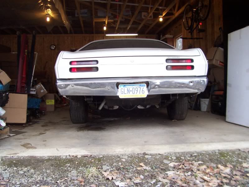

here's my car with the 68 b-body rearend, and my perches are moved for offset shackles. It fits better than an a-body rearend!
those are 15x7 with 4.125 backspacing and 225/60R15's
