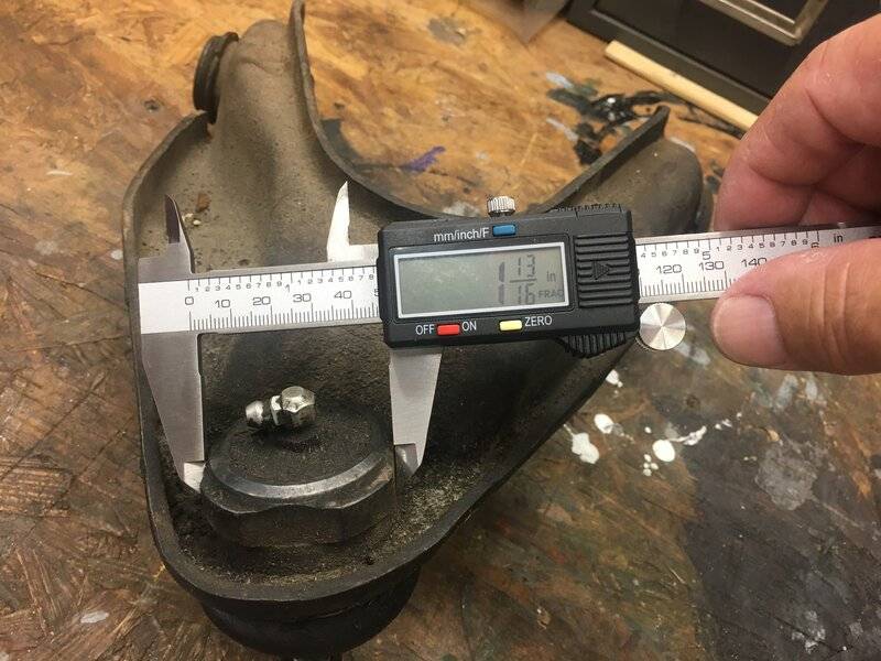

Late to the party. I could never figure out why the ball joints were designed with such a odd size on the flats. What were they thinking? :BangHead: :BangHead: :lol: 1 59/64" ??? WTF
I measured a small ball joint and got the same measurement as @RAT ROD AL 1 13/16.
That digital caliper that measures fractions is pretty handy I bet.
Yep, but I only use it for a "Hand Grenades and Horse Shoes" type measurement. I go to my buddy at the machine shop for REALLY important stuff.
Closer than a yard stick!
