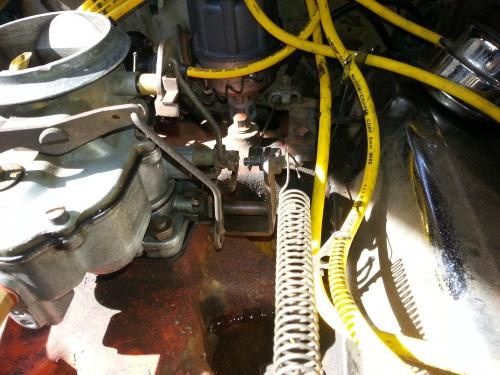

Ok guys, here is an update on my woe's with the missing trans TPL:
First of all, the fluid does still look the correct color of red and does not smell burnt. I did tie back the TPL at the trans and it did just as you described. Hard shift, but seemed to work ok. So, not it is tied back about 2/3 the way. I haven't been able to test drive it yet, as I had to remove the gas tank and clean it out (another casuality to the 5 years sitting).
I did take some pictures of the linkage setup I currnetly have, so... hoping some of you can help me with what I am missing. I have attached a few pics.
The car specifics are: 1965 Barracuda, 273 engine, Carter 2 barrell carb number on casting is 0-0612, 904 trans. If you need more info, please let me know. Also if you have any idea of where I might obtain the missing parts without breaking the bank, please let me know.
Thanks to all as usual,
Rick
