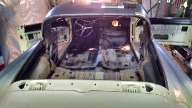

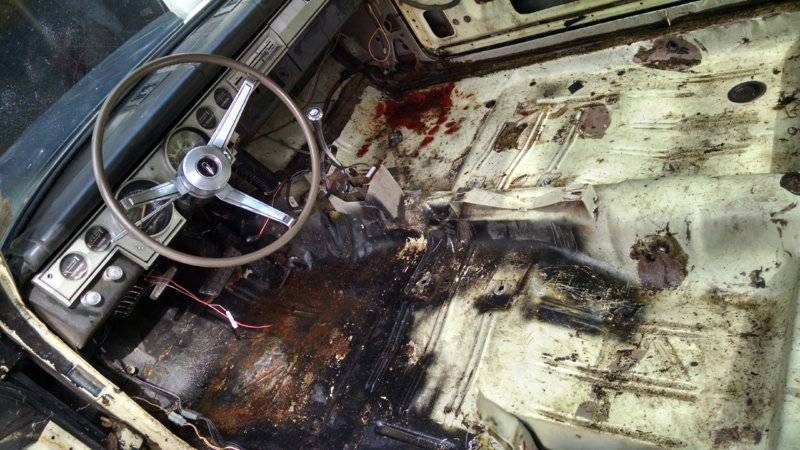

I'm going to install new carpet in my '66 Barracuda tomorrow (weather permitting). It is a V-8 A/T w console. I was looking at what I need to remove...seats...seat belts...etc., & noticed the gas pedal is attached to and pivots from the floor. I can't crawl under the car where it sits now, so I can't see what is holding it to the floor - if there's a bolt underneath. There is no screw or bolt on the top side. Is the gas pedal removable?.....and if it is, how? Does it snap off if I pry it?
I could GUESS where it goes & cut a slot, but that seems like risky business. Any other Early Barracuda carpet tips? This is my first shot at a Barracuda.
Thanks!

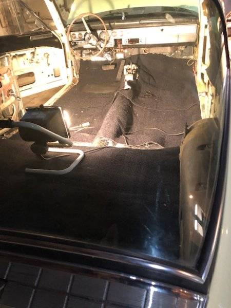

Had to jack the car up in tight surroundings & the 2 7/16" nuts were just above the exhaust pipe/clamp & under an AT line. The nuts were a ***** to get to, but broke loose easily. Pedal now removed. Now I can get to work! Thanks to all for your input.
