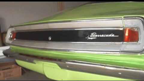

These guys are arguably the best available out there. I used them to do my surrounds and a few other grill parts. Their workmanship was nothing short of jaw dropping. Not cheap, but amazing. My surrounds were smashed flat in some places. These guys could restore a crushed aluminum can if they wanted to. Here's a link and some pictures.

If you have the cores, you are looking at $4k for both sides including repair, polish, and replating, paint and assembly. I spent $2k and had to paint and assemble them. They are a bit involved.
Once they were done they looked like new. Considering what my surrounds looked like when I sent them away, it was almost miraculous.

Having them restored was the final step of my exterior restoration. It certainly hurt the pocket book, but I felt I had little choice given that they are a one year only set of parts. The car looks stunning with them on there.
