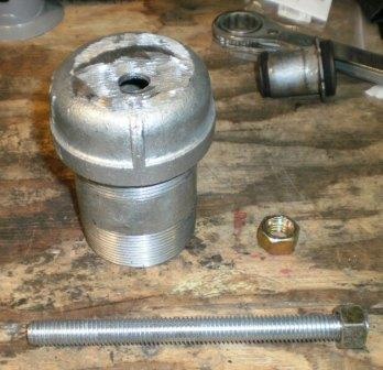

Pickles are hard on boots and personally i dont like beating the heck oughta anything [unless it a crook]...heres what iv made over time...short for upper a arm bushings and long or whatever fits for lower..and yes,it does help to have access to a bridgeport and a hardinge..but with some tlc and some pipe of different diameters you can cut and file flat all the lenghts you need...

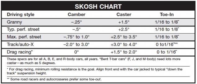

If you've got 700 to blow then yeah, that sounds like a rip off to me. Hope that includes the LCA bushings, not just ball joints, an alignment to the skosh chart specs, ride height adjustment, and a personal massage. If not $350 tops.
