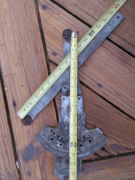

I have some regulators and all the hardware from a 67 notch .
does anyone know if this is the same as a fastback hardware ? Will it work in a fastback ?
Thanks for any help on this .
@Josecuda
G'mornin Al, No to the fastback. This is the drivers side from my 69 Fastback Barracuda.
Please let me clarify, mine is the 1/4 window, which is what you have.
Quarter window regulators in the convertibles are different also.
For future reference, these are the correct (rear LH) ones for a Fastback
