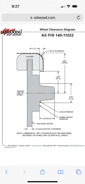

Wilwood makes a hub for sbp drum spindles that is bbp but it’s made for disk brakes. Not sure if you could make that work.
question: is that hub *technically* ford "BBP" with the larger center register? i vaguely recall this discussion in the not so distant past...
i do know *somebody* makes a disc kit for the sbp spindle that has bbp. and whether that's a dual pattern on a hub and hat or as a disc i don't remember.
Not sure exactly but all the specs are listed on wilwoods site including center register diameter. I’ll look.
i think factory center register BBP is 2.8?
only a concern if he wants to run factory rims, i guess. most aftermarket stuff is well wider.
ETA: just for edification, 2.80~2.85 is what i got
