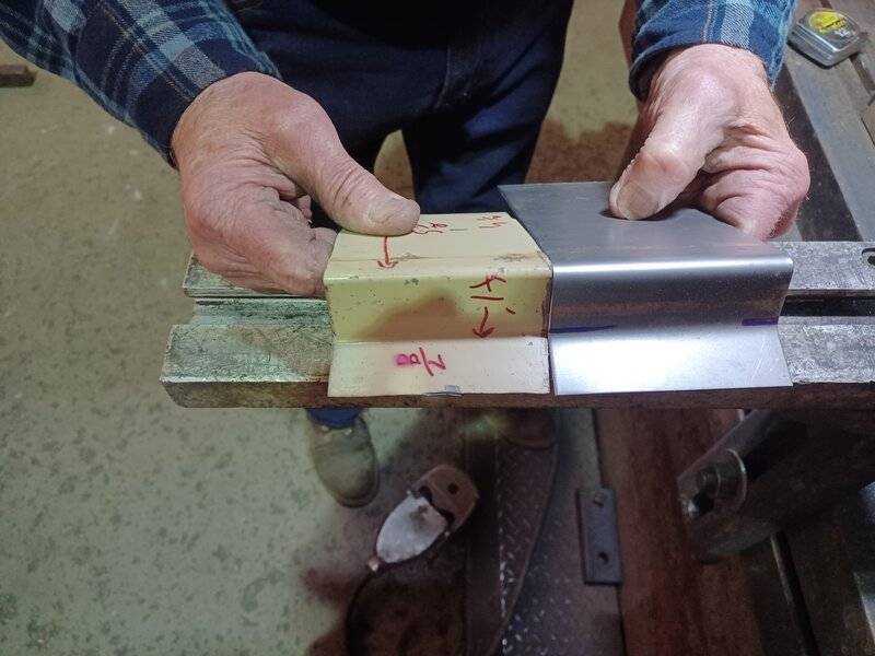

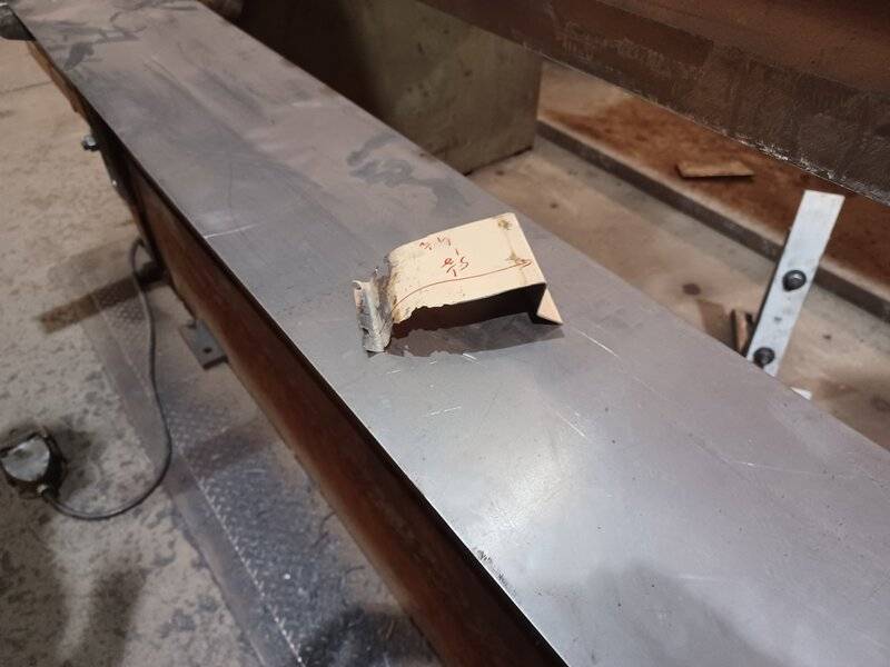

Luckily there was one section on the passenger side that had enough integrity left to use as a pattern.

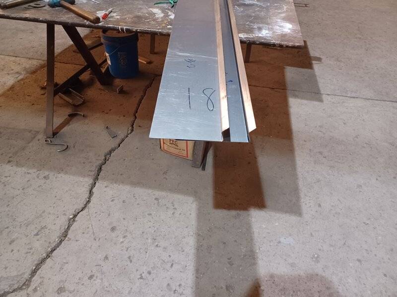

I got a sheet of 18 gauge steel and sheared it down to size a few months ago. Finally today I got around to making the first two bends.

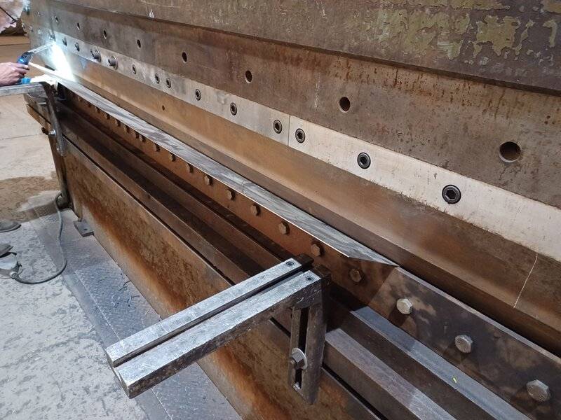

Will have to change out both the upper and lower dies to make the next bend and then another upper and lower die change to get the curve pressed in.
I am posting this project on here so others can see how it's done. I really couldn't figure out where to post it, so I just dropped it here for now,
Just changing out the dies and realigning them can take a significant amount of time. Add in the material, bending time, and your are getting up there on the piece cost.
So here we go on this project.

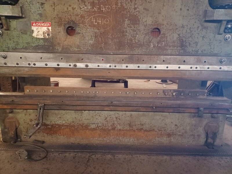

Of course the first thing I had to do was change out both dies to get a set in there that will allow over bending at a very sharp angle.
Got the first two of the four bends required done on 3 pieces and now I have to change the dies again to proceed. More to come.
