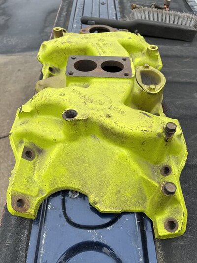

‘71-‘73 Van, Pickup truck non smog intake is like a a 340 4 barrel intake,
larger runners and will accept a
‘70-‘71 big block 2 barrel carter with no modifications. Casting # 3614345
What I forgot to mention is this is a factory 360 intake.:BangHead:

This looks very similar to whats on the truck now. I'll have to look closely when Im at the shop next. Its casting number is 2468960. It runs absolutely flawless with that intake and carb. Its a 1 ton shop truck that idles so smooth you cant hear it or feel it...and with a 4 speed and 4.88's, I really dont need to be "hopping it up".
