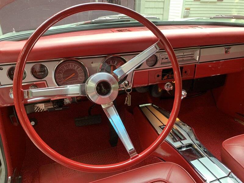

All my interior was done with single stage automotive paint. Scuff with scotch brite pad, clean with soap and water. Air dry. Light coat of primer sealer and 2 coats of paint. Rock solid. Excuse the missing radio, this was done before the radio came back from the rebuilder.
