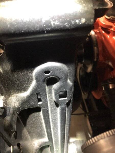

You could use an alum fan shroud , and make it a 2 piece like the older chevy pick ups--------------
look down the side to see where the top unbolts from the bottom
You take the radiator out, slip the fan shroud over the fan and let it hang on the pulley, install the radiator and then attach the shroud to the radiator. Any more questions?
