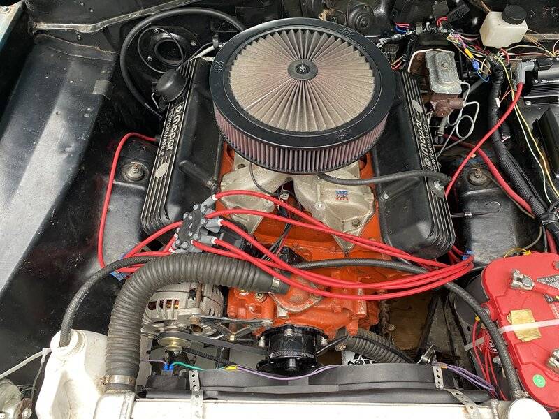

Added some ‘99 ford contour fans, a 180° thermostat, and a Meziere (or however you spell it) electric water pump. Cooling issues resolved! Drove the car to drag strip and hot lapped it a few times, letting it idle in the staging lanes for 15 minutes at a time between runs, and the temp never got over 195°!

This is the only picture I have right now. It looks a little ghetto, but I haven’t had time to make it nice yet haha
There’s about an inch between the shroud and the water pump.
This was before I swapped over to a Chevy style alt.
It looks fine... molded radiator hoses would clean up the appearance (and flow better too) :)
An inch?? That's a HUGE amount of clearance when it comes to big-block A-bodies
